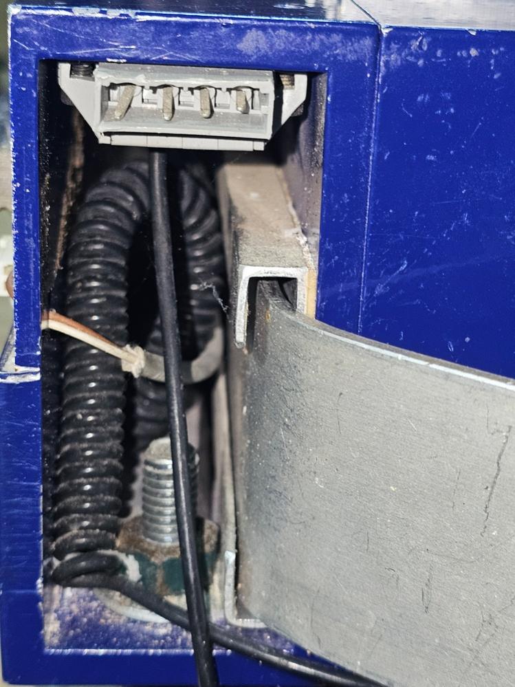

    Does anyone know what this wago connector was to be used for?
    The aluminum touch plate is hardwired and might be connected on the backside of this connector.
    Didn't know if this was used for or to be connected to the Indexer card which I do not have. yet...maybe.
    Thanks
    Don

    In my 2013 Desktop, that is complete and the upper left goes to the alligator clip, and right next to that goes to the Z plate.
    I know a guy in Oz that had problems with the wago, and hardwired it...maybe the same was done to yours?

    Thanks Scott,
    I haven't tested with with meter, but the Z plate works as it is.
    Was just making sure it wasn't for something else/.

    My alligator clip has lived on the front left leveler leg since Brady mentioned it.
    Check and see if input light comes on with plate...and if you have connectivity....saves a LOT of time clipping to the bit/neut/etc.
